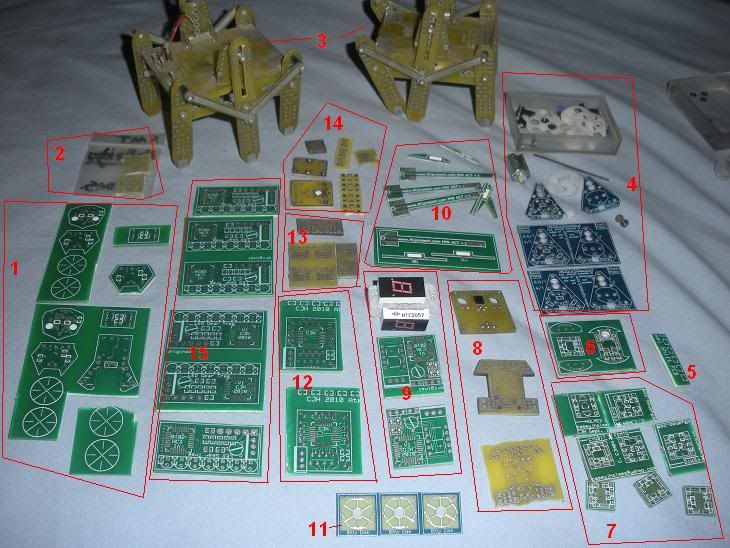

Here is SOME of the PCB's I have drawn..
I've even used it for mechanical designs like walking servo robots and ball bearing gearboxes.
(Right click and press view image to enlarge)
