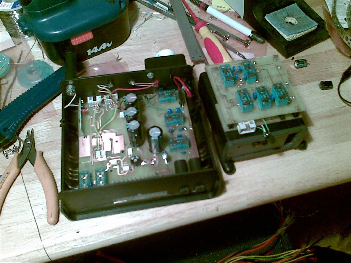

I'm planing to use filtering as it's in a picture. What you think about it? All improvement suggestions are wellcome. Coil(L1), I just chose the biggest available in Henry's(1000µH) without any special thought about it.
Also RC-protection over the transistors wonders me. I have seen many times used RC pairs(47ohm + 100nF), so is that right?
Previously what happen without good filtering:
Regards

When you apply power to this circuit F1 will see a surge of current as all the caps charge up which might reduce its life.
You probably do not need this, the diode should be good enough. You put in a TVS/Zener instead to provide overvoltage spike protection.
You should use a much smaller value inductor (if you even need it at all). 1000uH will probably cause some ringing when you connect power to your circuit.
Use a Schottky Diode for D1 if you want a lower voltage drop.
You can use larger value resistors on the base of the transistors say 1K to 4.7K
D2 is also not necessary unless you have >10uF on the output side of the regulator-- but it doesn't hurt anything to leave it there.
Hope this helps!

Wooooo ....
You didn't take half measures, Heguli ! (hoping this is a correct expression in English)
I think you will have good results with a little less filtering too.
The VDR (R3): I think it would do better when placed over C1. For C1 take a 35V version.
C2 .. C7: I think one 470 uF 25V will do fine.
For L1: 1 mH. 100 uH is fine. Mind the max. DC-current the inductor is designed for.
D2: I agree with John. It's not absolutely necessary, but I think it's a good habit. GMP. Good Manufacturing Practice.
The snubbers 47R + 100nF. When the BC547 is turned on, it has to handle the current from the 100 nF as well. And with 47R you go above BC547's limit.
A zener instead of the diode across collector-emittor will do the job for snubber and that diode. Zener 18v or 24V, 400 mW. All it has do do is to prevent that the collector-voltage rises above the BC547 spec.
And yes, as nanovate suggests: 4k7 in the base is fine.
For D1 and D2: take the ordinary 1N400x. Low-cost, simple and reliable. I don't see the need for a schottky for D1; there is plenty input-voltage left for the LM340 to regulate.
One more thing to think about: groundloops. Prevent that high currents can lift or sink ground-potential on the board in respect to chassis-ground.
I think it's very good that you put in so much effort in the supply-filter. Congratulations.
And in case you're looking for some good battery-noise/spike source: wiper-motor, interior heater fan and engine fan are the bad guys in a car. They are more disturbing than the ignition-coil.
Cheers

DO not forget to look at power dissipation. The LM340 in SOT-223 needs some copper area on the PCB otherwise you can put it into thermal shutdown when you try to draw too much current.
A quick calc: (13-5) * Iout = 0.8W if Iout = 100mA.
That's ok sense device is connected to constant powerline... hopefully it has to fire up only once :D
Basically you all think that less cap's is enough, so I took off C5-C7 away.
I checked the datasheet page 12, is it 1 sqr. inch area enough? If I need 1 ounce copper area it's going to be huge!
1 ounce = 0,02835kg
Cu = 8960 kg/m3
Cu laminate = 35µm thick copper layer
copper volume = 0,02835kg/8960 kg/m3
=0,0000031640625m3
copper volume/35µm thick copper layer
=0,090m2
=0,30m x 0,30m
A tip to decrease the dissipation on the 7805 is to have two or three diodes in series - the current and dissipation is well within their capability (0.7v at your suply current) and they can dissipate energy which would otherwise be dealt with by your regulator - you're supplying a couple of volts less to the regulator.
Always useful way, I have done the same thing. But this time it doesn't seem to do much? Vin 13V-5V*100mA =0.8W, with one diode:
Vin 13V-0.7-5V*100mA =0.73W
Done, actually I add that resistor.
I'll change the RC snubber and diode to zener. Is it fast enough to kill the possible spike?

For the copper-area: Your calculation tells that 1 ounce copper over a square foot means it's 35 um copper, and 2 ounce --> 70 um. So your math is OK :)
Have a look over here.
https://www.avrfreaks.net/index.php?name=PNphpBB2&file=viewtopic&t=47186&highlight=
What you need to do is calculate the power in the 340, and use page 12 to see how much copper-area is needed. And it will be less than 30 * 30 cm ;)
For the groundloops: where are you mounting this device? Under the dash? or in the engine compartiment? Under the dash you would probably search for a ground-wire and use that. But what is important to think about: do not use a groundwire that could carry a lot of current. F.i. rear-window defroster, wiper-motor etc. Take a clean ground.

About the relay-driver: BC547 is (looking at spec's) okay for this job. Yet I'd prefer something with more balls, like BC639 f.i.
Is the use of ULN2003 an idea?
:lol: :lol: ...I'll give it some serious thoughts, just because there is a lot of more balls. Otherwise I woundn't even consider it!
...I did, what catched me was the folks who answer wrongly suffer stomach aches. I'll always answer right to you!
Could you check the grounding on the board, blue area over the upper right. Also Atmega and crystal is under groundplate ...red area in a middle.

I tried to analyze the board, but without a schematic it's very hard ! Too hard. I'll PM you. And the Ground-potential-issue is probably not on the PCB itself. But consider this: if the ground-potential of this board is "lifted" by some other device in the car (f.i. rear-window-defroster) AND (logical AND) one of the other connections from this board is also to ground (closing the ground-loop), then turning on the defroster will create a current through this board. Pheeeuw ..... this is difficult to explain. Simular issues occur with switching PS's, audio-amplifiers etc.
In order to determine if a possible groundloop will cause problems, it is necessary to know what other in-car peripherals are connected to this board.
Btw, it looks like you are using the same 433 MHz receiver I am working with now.
And putting the SW-name in copper .... brilliant! I am used to do the opposite: In the software I describe to which assembly the SW applies.

From your burglar-alarm-board to the car-peripherals, you use relay-contacts (outputs) or optocoupler (inputs). The only groundconnection is battery-ground connection. So I think you're safe :)

Today first try with the new setup and same thing happend then previously, burned pin at atmega. PC5, which drive relay K1 wont work anymore.
Without the motor load everything works fine. If I connect all the motors it works few times, well maybe ten to twenty times and then the pin is burned.
Any ideas... I update the schematic above, it's the newest and what is now in use. I was wondering should I leave out the resistor R9 and maybe R3 as well? That way I would cut off the discharge path from the motors. Those varistors are 14VAC/18VDC.

Sorry to hear that !
I had a look at the updated schematics, but I am a bit puzzled: PC5 is connected to the opto-coupler, and R3 and R9 are varistors ..... What am I missing?
The current for the motors is going through the PCB-tracks. Take separate power-lines for the motors/relais-contacts.

What am I missing?
You are not missing anything, I am :lol: ...PC5! Sorry, I ment PC4.
I quess you are right. I just tought I can use the same powerline then the original powerlock controlbox.

Old setup on the right side, much smaller:
If you remember when I wrote about motors and how they return a bit back, you defined it as a spring effect... wont happen any more. In older version spike just didn't kill the pin, it also messed the EEPROM or during the write EEPROM it reset the chip.
Somehow I believe the varistor R9 leaked a hole lot of current and rise up the ground level on transistor emitter. Due the emitter rise also the base level rise. If base level rise above VCC while the pin(PC4) is up, it burns?
