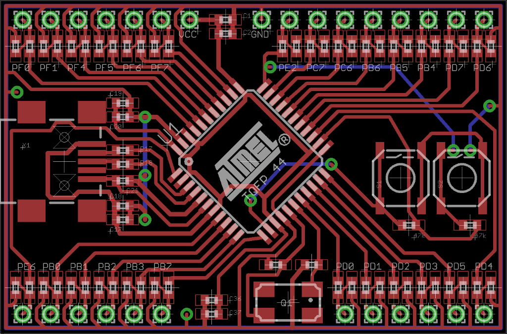

This is my first breakout board that has a micro-controller and the first to use surface mount components.
I'm not certain how to apply GND pour and/or VCC pour to the top and bottom layers. I've come up with the design based on comments gleaned from these forums. There's too much info via Google, some of which is contradictory. I can't tell the genius' from the fools. Confused
If you think I need to make additional changes then any comments are welcome. I intend to have this professionally manufactured for my hobbies.
Each port has two 603 components that I may populate with a voltage divider, RC filter, series resistor, or pass-through .... depends on the application.
Rick
Updated Files
Changes
Fixed 2x22pF capacitors to the uC GND (pin 15).
Added a ground plane under the uC footprint (only at the top layer).
Added a ground ring around the crystal.
Moved decoupling capacitors closer to uC.
Added a ground plane at the bottom layer.
Fixed "Acid traps" at bottom left connector.
Fixed missing ground for caps, upper right.
Added 100uF cap. at the pcb's supply point (USB port).

Nice try and welcome to the SMD area.
There are some things you have to change here:
1. Connect the 2x22pF capacitors ground directly to the uC GND (pin 14).
2. Draw a ground plane under the uC footprint (only at the top layer), and connect it's GND pins there (like you do).
3. Draw a ring ground plane at the crystal.
4. uC decoupling capacitors must be as close as possible to it.
5. Draw a ground plane at the bottom layer to fill your pcb.
6. Don't connect sensitive devices GND and Vsupply pins, to high or unknown ground paths (tracks) - You did it for the uC GND and Vcc. You better put an 100uF cap. at the pcb's supply point and then to draw different ground paths for each different sucircuit. One of them is the micro, another is the USB e.t.c.
5. If your pcb is small enough or/and there are no big currents at the different subcircuits you may follow suggestion 5, else suggestion 6 is better.
I hope this helps.
Michael.

Hi,
looking at the colors, I guess we are talking about eagle. But it is similar in other programms. You select 'polygon', choose the right layer and draw a rectangle. All other optional selections you find next to the 'width' pull down menu. The polygon rectangle should be bigger than the dimension limiting rectangle on the dimension layer. Now all you have to do is select 'name' and give the new polygon the right signal name 'GND' or whatever you used.
All areas that are not covered can be connected with vias. To update the pcb graphic use 'ratsnest'. Thats it!

Doesn't ARef just get a cap to Gnd? You show it tied to V+.
JC
Yup. Bass akwards.

icarus1 wrote:
Nice try and welcome to the SMD area. There are some things you have to change here ...
This is exactly what I needed. Thank you. It will take me a while to work through all of your suggestions.
For your first point, the two caps *are* tied directly to pin 15 ground. Are you saying they need to be equal length or and/or their only ground path must be through pin 15?
Rick

Please open this link:
http://www.necel.com/nesdis/image/U18172EJ2V0UD00.pdf
It is just a datasheet from a NEC microcontroller. Just take a look at Chapter 5.4 (System Clock Oscillators) and you'll understand what I mean. Those thinks are "musts" you have to respect in all of your designs.

I think Michael is making some good recommendations, but I am glad he has not seen some of my boards...
You may also wish to add a Version Number and Date to your board. You may, at some time, end up with a Version 2 board, and it will be nice to quickly identify them.
I would try to put a large #1 by pin 1 on the board. Helps keep me from making mistakes at 2:00 AM, when I'm tire, up against a deadline, in a hurry, ...
If you could fit a small pot on the board you could easily connect an LCD, as the pot will be useful for a contrast control. If yo envision it always being on a breadboard, or PCB, then this doesn't matter too much.

Nice design Smile
"Acid traps" at bottom left connector. Edit like bottom right connector.
Acid traps are narrow angles or small gaps that might be a problem when etching the board.
Why is it useful to do so? ( I understand the use of filling the ground plane on the bottom, but this seems to me a bit unnecessary )
The return path for the uC should have low impedance, doing a ground plane under the uC helps on it, because the connection with the return path is near to the GND pins.
