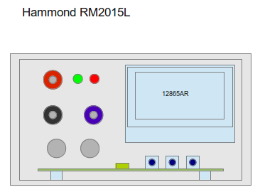

Yes, enclosures and packaging it all nicely are an entire chapter. For now I think I'll box it into a plastic enclosure from Hammond (RM2015L).
I've come up with the following mock-up. Not really happy with it yet. But I'll have to have an enclosure in my hand, but they are out of stock everywhere...

This is my mock-up
Size matters. I prefer large knobs Wink

Yes, I like large knobs too, but also a large display, the bigger the better. But in real life there have to be compromises.
I find there is an imbalance between the big knobs and the small display on your panel.
You're so right, Markus. It's all compromises here as well. I compensated for the small display by using a large font.
I have had a few of these old-style mobile phone displays for 6~7 years now (when I started with AVR's), and only used one so far. This was a project in which I could use all of them. Although small, they're pretty good readable. The backlight is a pain: it takes 60mA from an isolated floating supply. Need to find a fix for that. It is and will remain a Project ....
The Dual Lab Supply is better proportioned IMO.

That is a nice front panel. What was the cost ?
I've decided to use a 128x65 graphical LCD. It is similar in price as a same size character LCD ($14) but gives me a lot of flexibility in what I can display. The biggest limitation will be the available flash size (32k).
Markus

In the short term I'll concentrate on getting the electronics and firmware working. The we'll see again about the details for the box for the device.
One related problem to solve is with the display. It is a chip-on-glass display with no specific provisions four mounting it. In the prototype I'll probably just hot-glue it to the front panel from behind. Will look ugly, but only on the inside Smile.
Markus
 View user's profile Send private message Send e-mail

If the display has pins, I'd mount on a PCB that has at least two holes. Depending on the case construction you either place threaded studs on the backside of the frontpanel or use a separate frame for it. Like having two frontpanels, one internal where you mount buttons, pots, jacks and possibly the display on, and the visible one. This will give a clean look without any visible mounting hardware.
Nard, there is no display in the picture I posted, so which display is nice? Smile

No I've fallen for the COG displays from Newhaven. The specific one I'm using is the NHD-C12865AR-FSW-GBW. It has a flex-cable and I provide a mating connector on my board. The display area is quite large ca 50x30mm with not much border. There is also a bigger version, ca 10mm bigger, if I have the space to upgrade.
Markus
