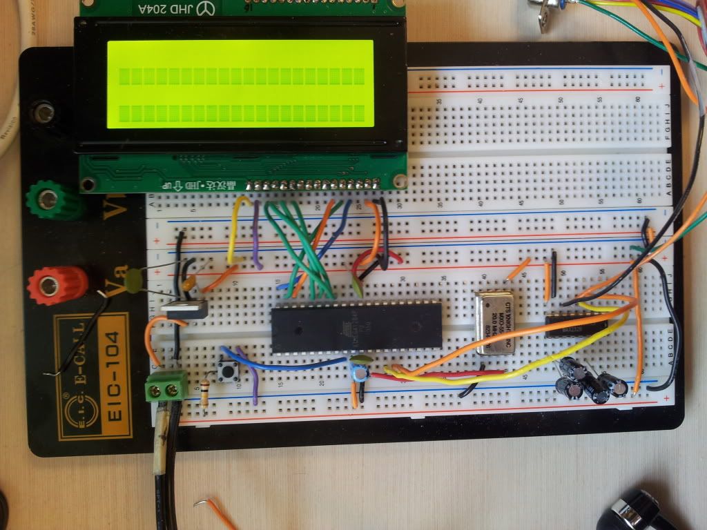

Here you go. I forgot to switch the oscillator back before I took the picture, but the connections are the same nonetheless.
Let the criticism begin! I tried to color code it, but it's hard (sorry). In general orange is Vcc and black is Vss. Also, the reset button cap is missing because... I don't know where it went. It works without it.
Green flat caps are 0.1uF, yellow "flat" is 10uF, blue bucket cap is 1uF, black buckets are 10uF. The lone resistor is 100k, I think.
Vcc rail measures at 4.97V.

As Uncle Bob says, 1uF electrolytics are no good for digital circuits. You need 100nF ceramic capacitors. You also need reasonable physical layout with 20MHz.
Okay, I will find some 100nF caps.
Edit: I found them, they're in the shot. Should I remove the teal colored 1uF one?

Looks to me like the oscillator is plugged into xtal2. Datasheet says on page 35 to use xtal1. Tell me if I found the problem.
Yes! Very Happy
I wonder how long it's been like that for... Embarassed I think I assumed (never assume) XTAL1 would be before XTAL2 in pin numbering. Hmm.
I'm surprised anything worked at all! Do you have any ideas how this could result in resetting? I'm honestly curious now how the uC did anything, especially send things correctly to UART.
However, the 115200 baud rate is still giving me problems. I will get a crystal with a baud frequency and see if that helps.
Any other comments on the circuit layout?

You have posted an excellent photo. I wish that others could be as neat as you. And if they could use several different wire colours like you have !!
Uncle Bob's razor sharp eyesight spotted the XTAL2 immediately.
You should be ok with the 100nF caps. The blue cap is fine too.
Double check the Procyon code. Everything will be better after a nice cup of tea.
